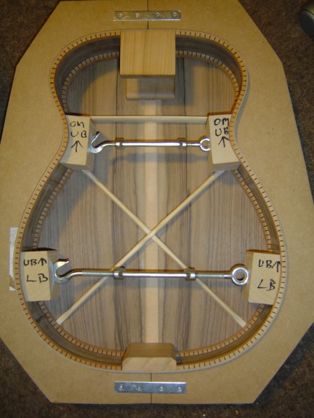

Many of us though are now using an X-brace on the back as well which will hold the back to better dome without the added stresses of relying on the glue bond with the rim.
This gives you the idea.
